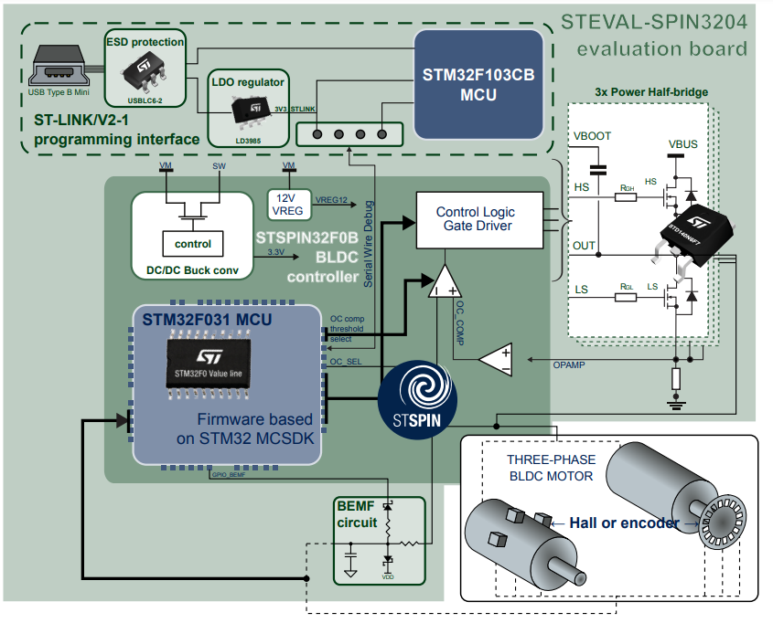

What external interface do the STEVAL-SPIN3204 have for controlling the motor?  I spent a minute or so looking through the user manual and couldn't tell other than they have an on-board pot to control speed (I think).  You need some way to tell each board either the speed or position you want to to move to, and if all you can control is speed then you need a way to read its position so that YOUR code can handle the position servo.  Often people use "step-servo" drivers for this purpose - the interface is 2 digital signals (step and direction) just like a stepper motor.
If you can modify the SPIN3204 firmware you could probably add the "step servo" interface to it.  Then use the timers on your NUCLEO-144 board to generate the step signals.

It appears that the STEVAL-SPIN3204 boards provide a connector to the board's microcontroller UART peripheral.  You could use that to connect to UARTs / USARTs on the Nucleo board.

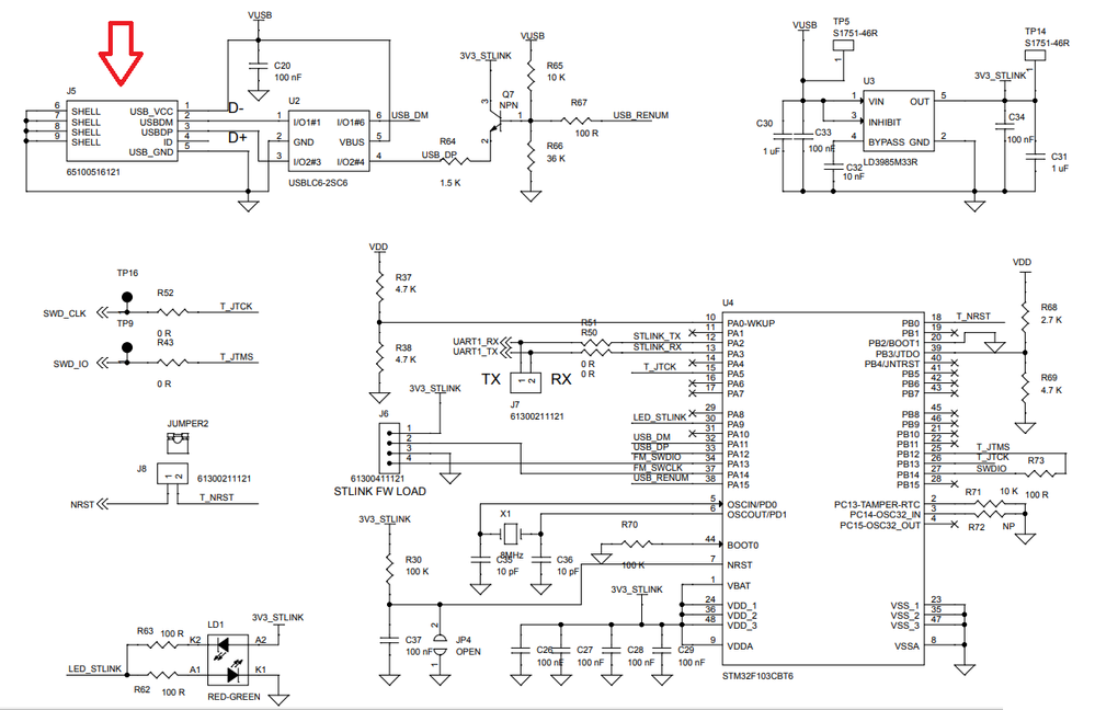

And I wanted to ask you another question. I know that you usually need 2 connections, 1 for Step and one for Direction
I have added a picture for you marked with a red arrow pointing downwards. This is the connection of the board. It is a USB 2.0 Type B Mini input and the question with this is suitable for connecting Step and Direction. Although it is possible to control steps and operation through the computer, I need to know which wire goes to Step and which wire goes to Direction I am also adding a link to the STMicroelectronics official website where there is a full PDF file with a simple explanation I got a bit confused with this
Bob S
DO you want to use the USB interface (and USB protocol) to send step/dir - that is not possible.  USB transfer rate is too slow.  Or do you want to re-purpose the USB connector and use the D+ and D- pins as your step and direction signals instead of USB signals?  That may be possible.
Either way, I suspect (but I don't know for sure) the ST motor application does not support step and direction inputs.  If it does not, then you will have to add that functionality to the motor app.  And remove any USB code that it contains.

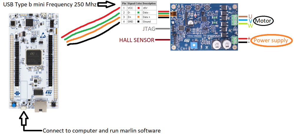

Shlomi9137
See i want like this line u write "Or do you want to re-purpose the USB connector and use the D+ and D- pins as your step and direction signals instead of USB signals"
I make little wire diagram the i want use 6 motors control, The board can work in like 130-137 Mhz frequency in PWM the board have like 10-12 pin support pwm
At single motor maybe i use setting max 20 Mhz, 20 Mhz X 6 MOTORS = 120 Mhz and board can support like 130-137 Mhz
And I realized that there are also connections of
USART_RX USART_TX
What it means?
And what is the best way you can recommend to me to connect the motors, of course I have 6 boards of STEVAL-SPIN3204
I am adding a picture I made
Bob S
Yes, that is how you would wire step/dir pins to the SPIN3204 boards.
I cannot tell you how to wire your motors.  If you can't figure that out by reading the documents, try finding a CNC forum.
You show a USB connection "to computer and run marlin software".  I thought the marlin s/w (really firmware, based on grbl) runs on the STM32 with the PC sending G-Code commands to the STM32.
And what the heck is this about 250MHz on USB type b and 20MHz x 6 motors?  And what board can support 137 MHz?  Are you expecting to generate step pulses at a 20MHz rate for each motor?  That is WAAAAAAAAY beyond what is needed for almost every CNC maching I've ever heard of**.  And you aren't sending the step pulses for all 6 motors over one pigtail USB cable.  There is one cable for each motor board.
** the exception being machines with huge reduction gearing to support motion resolution in the micron range yet still allow fast moves over relatively large distances.
My intention was that USB 2.0 Type B Mini can support up to 250 Mhz
And I don't use every engine at 20 Mhz, I mean that I can set every engine up to a maximum speed of 48 Mhz in the software, I set every engine up to a maximum of 20 Mhz, but that doesn't mean that I will really use a speed of 20 Mhz, it will probably be much, much less than that, I just wrote it down It!
STEVAL-SPIN3204 can work up to 48 Mhz directly with a USB connection to the computer I use this board for CNC so because I need some motors so I thought to do it
And say after all it's okay to connect it as I mentioned in the picture?
And of course thank you for your help!
