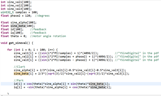

This is the first time I have to implement a PMDC motor control system.
There are 3-phase sine currents need to be converted into d-q components using Clark and Park.
I don't have the motor to test yet, so with the DAC I created three 120° phase-shifted sine waves that I need to convert into d-q components. This is an example of the code I wrote:
My questions are:
1) Is this code sufficient for conversion?
2) Is there an implementable library that performs these calculations? I found only this, but it is not clear to me what it can do
Can anyone, in general, give me some more information on how to proceed?

2024-03-18 7:51 AM
Dear @luke514,
ST provides a complete implementation of FOC algorithm available here. Feel free to download the MCSDK and generate a simple project for your hardware (select one of the provided motors if you don't have one). A lot of documentation is provided with the MCSDK,
We unfortunately do not have the bandwidth to provide feedback on user's code. I let the community answer.
Regards
