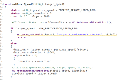

By using MC_ProgramSpeedRampMotor1 api trying to change ramp in six step algorithm
soundarya_h_s
The MC_ProgramSpeedRampMotor1 api is created in six steps to modify the ramp; however, ramp changes cannot be made with this api.It is possible to modify the ramp in FOC by using the MC_ProgramSpeedRampMotor1_F api.
Additionally, two produced APIs are supplied in FOC; however, in the Six Step, just MC_ProgramSpeedRampMotor1 generated.
I am unable to modify the ramp using the MC_ProgramSpeedRampMotor1 api in six step. Could you please assist me? Is there another method to modify the ramp in a six-step algorithm?

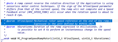

I generated a 6step project and added
MC_ProgramSpeedRampMotor1(333, 5000);
in main.c and it works pretty well. The speed is gradually changed to 2krpm in 5s. Consider that a change of sign in the speed (spin rotation change) is not allowed in 6step and forces the motor to stop. What exactly is the issue you are facing?
This is the code i am using to generate the ramp in six step algorithm, The MC_ProgramSpeedRampMotor1 api is created in six steps to modify the ramp; however, ramp changes cannot be made with this api.  Could you please assist me? Is there another method to modify the ramp in a six-step algorithm?
Are you sure that the effect of your code is not an overcurrent event?
I see an error in the usage of the speed. As indicated in the documentation the api accepts the speed expressed in #SPEED_UNIT.
So, I suggest to use the macro RPM_2_SPEED_UNIT(rpm) to convert it before calling the function.
MC_ProgramSpeedRampMotor1(RPM_2_SPEED_UNIT(target_speed), duration);
