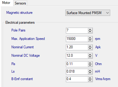

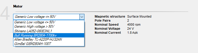

If you use the STM32 Motor Control Software Development Kit (X-CUBE-MCSDK) you can find the motor Bull Running BR2804-1700kv in the drop down list (when you create a New Project).
Otherwise you can use the available Project example for P-NUCLEO-IHM001 (3-shunt, sensorless).
In both cases you can find the Motor Parameters needed.
