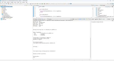

Hi, I'm trying to connect B-G431-ESC1 board, with no success.
there is always : try to configure the board
I complile and flash a sample project successfully on the board. However still cannot connect motor profiler to make precision tuning of the motor. Any ideas why it cannot connect?
Thank you, Kamil

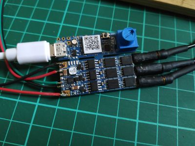

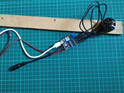

Not sure If I correctly understand your question. I'm using the B-G431-ESC1 board, with the daughter board not removed, USB cable that comes with the board, 24V 2A power supply, motor is 2810 900Kv 6s 7pole pair.
STlink V2-1, stlink 007 and 009 drivers, latest firmware upgraded via cube programmer.

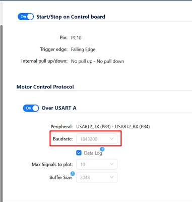

Could you explain why you changed the baud rate to 115200? The default value is 1843200.
I also have a project for the B-G431-ESC1. Could you please try it on your side without changing anything in my code? This project runs FOC, not the motor profiler. Please flash it to your board and confirm whether the UART is working correctly.
Kamil1
Hi Duc, thank you for the your foc project, I'm going to flash it to the board and lets see if there will be successful connection to the motor profiler.

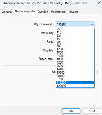

There are two reasons why I have changed the baudrate to 115200.
first: I was following this video
https://youtu.be/YSI_pBACLOo?si=puo3IlvAi9nuM24o
and second - there is no option for 1843200 in properties of virtual com port.

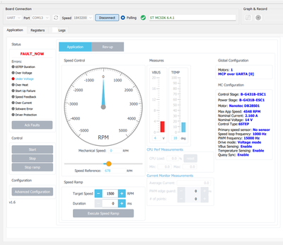

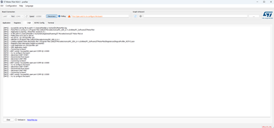

I have used your foc nanotec project, build and run, however I'm still getting the same issue:
Port Open, try to configure the board,
aspep beacon timeout 500ms
Why did you configure the baud rate to 115200 when this setup operates at 1843200?
