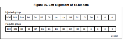

In the R3_2_GetPhaseCurrents(), the following line reads the ADC data register.
hReg1 = *pHandle->pParams_str->ADCDataReg1[bSector] * 2;
The value of the hReg1 will be used to compute the phase current later.
Why is the value of the ADC data register multiplied by 2?
Thanks in advance.

Hello @david11 ,
I guess you are using a STM32F4 MCU.
From the release manual (RM0368 Rev 5) , page 221, you can read this :
The converted data value from the injected group of channels is decreased by the userdefined offset written in the ADC_JOFRx registers so the result can be a negative value.
The SEXT bit represents the extended sign value.
For channels in a regular group, no offset is subtracted so only twelve bits are significant
With the following table :
As the FW consider the data left aligned, we must multiply the read value by 2 to align D11 with bit 15.
Hope it helps.
Regards
Cedric

I’ve figured it out a few days after I posted the question. I haven’t checked this forum for a while. Thanks a lot for your useful reply. It helps me make sure that my way of thinking is correct.
