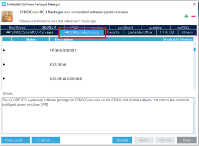

Hello @JavierRomann and welcome to the community,
How did you load that package to "CubeIDE"?
It's not available in the list of CubeMx: Software Packs / Manage Software Packs / STMicroelectronics:
‎2024-12-02 2:44 AM
Hello @mÆŽALLEm, thanks for your reply!
I load it via manually by the "From Local..." button. The expansion was downloaded via STM page https://www.st.com/en/embedded-software/x-cube-rc-calib.html.
Thank you very much for your time and assistance.
‎2024-12-02 2:48 AM - edited ‎2024-12-02 2:56 AM
I don't think this is possible as CubeMx doesn't list it. Meanwhile, I will escalate your request for conformation.

‎2024-12-10 1:34 AM - edited ‎2024-12-10 1:34 AM
Hello @JavierRomann ,
I've got the feedback. As I said as the package was not listed in Software Package in STM32CubeMx, it's not a standard CubeMx standard package. So you need to copy and add the files manually to your STM32CubeIDE project.
Hope that answers your question.
