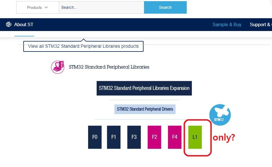

why doesn't have sample source code about stm32 standard peripheral libraries for STM32L0x series?
sw lee
i done make working file with STM32F031F6(STM32F0xx_StdPeriph_Driver) at the first time...
and now, we will change to STM32L031F6(STM32L0xx_StdPeriph_Driver) ..
but doesn't have in https://www.st.com/en/embedded-software/stm32-standard-peripheral-libraries.html
so i try to with STM32CubeMx...some function has working well but have trouble with TIM2 and I2C1... i cann't find problem.... lol
so just i want try with STM32L031F6(STM32L0xx_StdPeriph_Driver)..that's is simple
ask to who???

Hello @sw lee​ ,
There is no new Standard Peripheral Library developed since STM32Cube package was announced.
This is applicable for STM32L0,STM32L4, STM32F7, STM32H7...
For STM32L0 (as well as STM32F0) you have the option to use snippet code or LL drivers available in the STM32Cube package.
 -Amel

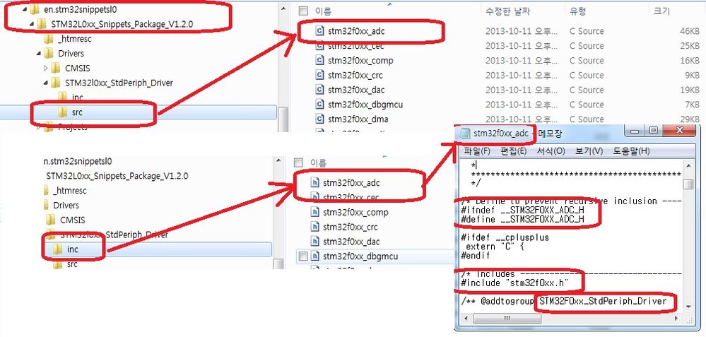

 but, when i use to snippet code(with en.stm32snippetsl0.zip), so many not matched for STM32L0.
 source has refer to STM32F0xx many times
like down picture
and i was tried to LL drivers available in the STM32Cube package before..
i failed also..
