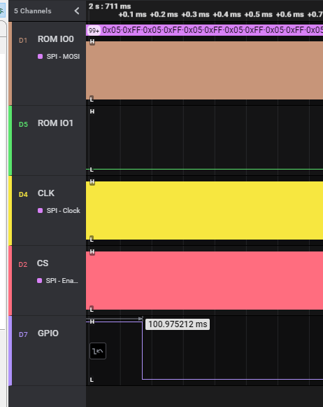

HAL_GPIO_WritePin(DBG_PIN_1_GPIO_Port, DBG_PIN_1_Pin, GPIO_PIN_SET);
err = HAL_QSPI_AutoPolling(&hqspi, &sCommand, &sConfig, S25F064L_TIMEOUT);
HAL_GPIO_WritePin(DBG_PIN_1_GPIO_Port, DBG_PIN_1_Pin, GPIO_PIN_RESET);
if (err != HAL_OK)
HAL_QSPI_Abort(&hqspi);
Setting the Mask Match to 0x02 is making me having this issue, since the value returning and expected by my product is 0x00. It was at first a mistakes of mine, but I then realized that this behavior is not what I was expected and can't get it work properly with the wrong value.
I am sure than the timeout is working properly since my external pin is toggling as expected (after 100ms) as you can see in the screenshot of my logic analyser.
But you can also see than the communication is not stopping even with the presence of the HAL_QSPI_Abort command.

In the description I made a mistake and mean match instead ok mask, sorry.
Concerning the assertion for this test I did the failure in purpose, since my goal is to stop the Auto Polling after an unsuccess match.

The timeout seems to be working. The pinout toggles as expected. Did you check the QSPI registers set by the HAL? It's surprising HAL_QSPI_Abort does not reset the autopolling flag in the QSPI registers.

The timeout seems to be working fine as indicate by the GPIO on the logic analyzer.
Concerning the memory, the chip is a slave device and the STM32 the master. Here my issue is the master never stop polling the QSPI memory (slave) even after the end of the timeout or the HAL_QSPI_Abort().

Yes the timeout is working, I played with different time value and the GPIO pin is evolving as expected.

I've walked the code, and a lot of the BSP code examples, and there doesn't seem to be any proper handling of the Timeout situation. The code itself time's out, and then subsequent code typically drops through with an error, but it doesn't seem to do anything to address the error, or stop the QSPI/OCTOSPI peripheral, and leaves the instance state in a BUSY condition.
None of the reference code uses the HAL_QSPI_Abort(), and in one of the L4 BSP examples the AutoPoll is actually emulated by doing normal reads, and mask/compare at the edge of a do-while loop.
So you don't have to regress a massive amount of code you might want the default behaviour for the HAL_xSPI_AutoPolling() to abort/stop the current bus activity in the TIMEOUT case

I think I understand what you're seeing/complaining about. All the reference/example code entirely ignores this failure mode/path
The underlying abort should be initiated via
/* Configure QSPI: CR register with Abort request */
SET_BIT(hqspi->Instance->CR, QUADSPI_CR_ABORT);
or
SET_BIT(QSPI->CR, QUADSPI_CR_ABORT);
The other alternative perhaps via QUADSPI_CR_EN clear/set
