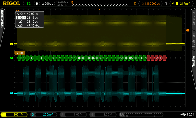

With an STM32F764 I want to receive 33 bytes from 11 daisy-chained 24 bit ADCs via SPI in read-only mode. The received data looks okay but there are 37 to 39 bytes in the buffer. Also with other byte numbers I receive 2 to 6 bytes more than expected.
HAL_SPI_Receive_DMA is called by a GPIO interrupt from an external ADC when the 33 bytes are ready. After finishing the DMA the buffer content is processed in Sampling(). There is no other communication taking place on SPI3.
I have attached a scope screenshot which shows the excess data in red.0690X000008j363QAA.png

So is there a bug in SPI_DIRECTION_2LINES_RXONLY?
I changed it to SPI_DIRECTION_2LINES and programmed a Tx DMA but so far I couldn't receive any bytes.
In HAL_SPI_Receive_DMA I found:
HAL_StatusTypeDef HAL_SPI_Receive_DMA(SPI_HandleTypeDef *hspi, uint8_t *pData, uint16_t Size)
  HAL_StatusTypeDef errorcode = HAL_OK;
  if ((hspi->Init.Direction == SPI_DIRECTION_2LINES) && (hspi->Init.Mode == SPI_MODE_MASTER))
    hspi->State = HAL_SPI_STATE_BUSY_RX;
    /* Call transmit-receive function to send Dummy data on Tx line and generate clock on CLK line */
    return HAL_SPI_TransmitReceive_DMA(hspi, pData, pData, Size);
It looks like HAL_SPI_TransmitReceive_DMA is called here to clock out the number of bytes in Size. But it doesn't.

S.Ma
Principal
Don t use
Use
Even if you don t activate MOSI as gpio.
And program both dma rx for data collection And Dma tx to control how many sck periods to generate.

Now it works. I have added a dummy Tx DMA for the number of bytes I want to receive:
/*DMA 1 / channel 0 / stream 0 transfers data from external ADC to sample registers*/
        __HAL_RCC_DMA1_CLK_ENABLE(); /*DMA clock*/

The Tx DMA is called together with the Rx DMA:
/*Data ready interrupt (/ADC_/DRDY) of external ADCs*/
void EXTI9_5_IRQHandler(void)
    HAL_GPIO_EXTI_IRQHandler(GPIO_PIN_7); /*clear interrupt*/
    HAL_SPI_Transmit_DMA(&hspi3, NULL, ChNo * 3); /*send dummy bytes via SPI*/
    HAL_SPI_Receive_DMA(&hspi3, SplRxBuff, ChNo * 3); /*get ADC data*/
