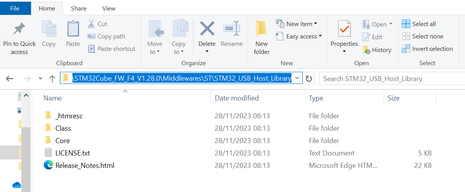

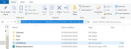

The USB-HOST library version depends on firmware package and also on firmware package version.
Could you please specify which firmware package you couldn't find the USB-HOST library Release note?
I checked some firmware packages, the  USB-HOST library releases notes are available in STM32CubeH7, STM32CubeF4 and STM32CubeF7.

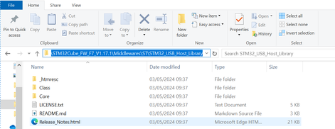

If you use STM32CubeF7, you can find the STM32_USB_Host_Library version in the Release_Notes. (STM32CubeF7/Middlewares/ST/STM32_USB_Host_Library Release_Notes.html).
Now the the STM32_USB_Host_Library version 3.4.1 is integrated in STM32CubeF7 1.17.1.
So you can refer to this post to update the upgrade the USB middleware to 3.5.2 version.

Hi @KDJEM.1,
I checked in the firmware package repository and I found the Release Notes. But in the project folder (Middlewares/ST/STM32_USB_Host_Library) is not present.
Thanks for your help.
