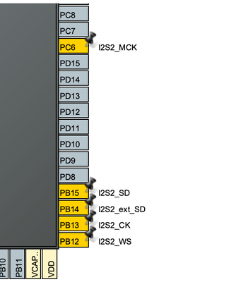

Please excuse the basic question, I am reading the datasheet of stm32f429ve trying to understand which pins I need to send data from the microcontroller to an audio codec using I2S.
I understand the I2S interface requires three pins, with an optional fourth pin:
  1. Bit clock, using PB13 = I2S2_CK
  2. Word clock, using PB12 = I2S2_WS
  3. Serial data, using PB15 = I2S2_SD
  4. Master clock, using PC6 = I2S2_MCK
However, I do not understand the function PB14 = I2S2_ext_SD.
Is this dependent on whether the pin is transmitting or receiving like MOSI or MISO in SPI? I cannot find this documented anywhere which makes me think it must be obvious :)

Just set it in Cube and you see... or rtfm.  :)

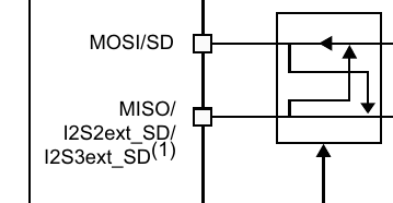

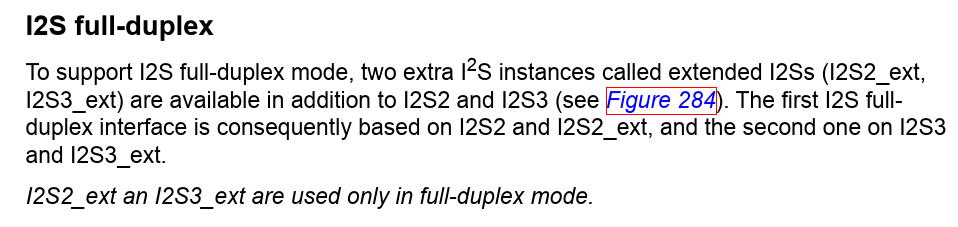

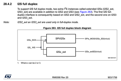

The SPI/I2S module in STM32 is only simplex when it operates in I2S mode, i.e. it has only one data line. To support full-duplex I2S,  for some SPI/I2S modules 'F429 (and a few other STM32) incorporate a second, simplified SPI/I2S module called I2Sext, which has only I2S mode (no SPI mode) and its clocks (WS and CK) are internally interconnected to its "partner" SPI/I2S module.
So, if you need fullduplex I2S, you'll need both I2S2_SD and I2S2_ext_SD (and you'll need to set up both SPI2/I2S2 and I2S2ext). If you need only simplex I2S, you don't need I2S2_ext_SD.

Thanks for the really helpful advice everyone, that is totally clear. I was searching the PDF and didn’t find that diagram, will be less lazy next time :)  because it is not in the data sheet. Instead it is in the Reference Manual RM0090 and appears to be slightly different.

I am a bit late this conversation but I needed an answer to the same question. I get the I2S_ext is a simplified I2S peripheral connected to the I2S/SPI module but my question is how can I configure I2S3_ext peripheral for example_ I can see that it is memory address is 0x4000 4000 - 0x4000 43FF according to the "STM32F427xx STM32F429xx" datasheet but in the reference manual RM0090 there is no mention of configuring I2S_ext modules
Configure it in the same way as the "normal" I2S/SPI modules, except that there is no SPI functionality and no I2S Master functionality.
