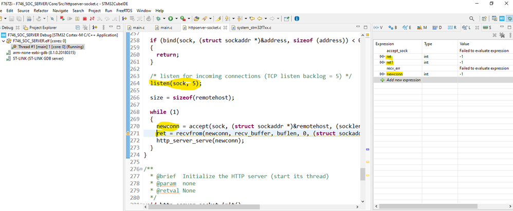

sunil
Hi @Imen DAHMEN​ ,
Thanks for your support. I have tried LwIP_HTTP_Server_Netconn_RTOS from the example code and it works in NUCLEO-F746ZG. and also i searched example for SOCKET_API but it is not there for this NUCLEO-F746ZG board. I tried on own with help of STM example from some other board. The initialization was working fine but during entering IP address
it return the value -1
ret1 = read(conn, recv_buffer, buflen);
 if(ret1 < 0) return;
and the full http-server-socket code is

and is there any STM example for websocket message transferring
I didn't find any STM example for LWIP for the STM32F407. If it there please provide the link
sunil
I found that problem in socket accept function
see the attach picture
it returns value newconn as -1 with listen(sock,5) and also listen(sock,8)
