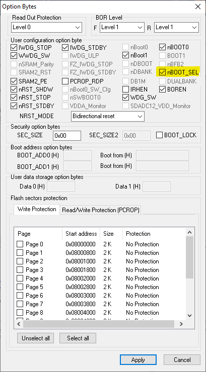

However, after doing so I am no longer able to access the bootloader. Whenever I reset the chip while holding BOOT0 high, the chip just seems to run the main program I uploaded. I've also tried to hold BOOT0 low and reset, but with the same result.
In the meantime, I found out that I should be able to use my ST-LINK with the mode "Connect under reset" to program the chip that way even though the SWD pins are reassigned after reset. I will report back with my results.
‎2020-04-24 12:33 AM
I can confirm that using the "Connect under reset" option with a ST-LINK device works. I connect 3v3, GND, SWDIO and SWCLK to my microcontroller and hold nRST low as I press "connect" in the STM32 ST-LINK utiliy. I then "quickly" pull nRST high and the program is able to detect the device.
I'd till be curious to know why I can no longer access the UART bootloader.

I would guess, You had empty memory, when You tried first. So Bootloader was activated because of empty memory and not BOOT pin state. Try to connect with ST-Link via STM32CubeProgrammer and check option bytes. ST default production value for nBOOT_SEL is 1, which means it is by default ignoring BOOT0 pin and takes signal from nBOOT0 bit in Option bytes. For more information about Option bytes please check reference manual, section 3.4. FLASH option bytes.
If You will change nBOOT_SEL value to 0, You can then use BOOT0 pin again.

‎2020-04-24 6:50 AM
I can confirm this.
Using the ST-LINK utility, I connected the target with the previously described "connect under reset" method. Then I opened the dialog Target -> Option bytes and found that nBOOT_SEL was checked, meaning that the state of the BOOT0 pin is ignored and the activation of the bootloader is determined by the state of the nBOOT0 bit (3 positions above nBOOT_SEL in the picture), which is checked, meaning the bootloader will not be activated.
Thank you all for the help.
