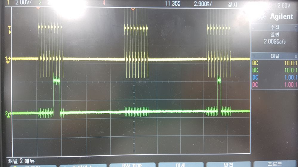

I'm working with Nucleo-F410Rb, which has STM32F410Rb as MCU.
Now I'm developing SPI connection by using Zephyr.
Zephyr is maybe not suitable for this forum, but i wish get any clue or idea for my problem.(something like hardware parameters, physical issues etc.)
I make test source code referred to /samples/driver/spi_fujitsu_fram source code,
here's a oscilloscope result. It shows SPI1 MOSI, and each value is 0x01, 0x02, 0xff.
As you see, patterns looks very weird, and I don't know why MOSI output looks like above..
Here's my test source code.

	spi_cfg.operation = SPI_WORD_SET(8);
	spi_cfg.frequency = 5000000;
	spi_cs.gpio_dev = device_get_binding(DT_ST_STM32_SPI_1_CS_GPIOS_CONTROLLER);
	spi_cs.gpio_pin = DT_ST_STM32_SPI_1_CS_GPIOS_PIN;
	spi_cs.delay = 0;
	spi_cfg.cs = &spi_cs;
	k_sleep(1);
	while(1) {
		for(i=0; i<16; i++) {
			err = koo_spi_write(spi, &spi_cfg, 0x01, 0x02, 0xff);
			printk("%d: SPI OUTPUT %d\n", err, i);
			k_sleep(100);
Thanks for read my post, and plz tell me what's the problem or what i have to look for.
