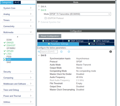

Setting
audio_control[0].ux_device_class_audio20_control_sampling_frequency   = USBD_AUDIO_FREQ_48_K;
automatically triggers
                    if (control -> ux_device_class_audio20_control_sampling_frequency != 0)
                        break;
if there's a set request UX_DEVICE_CLASS_AUDIO20_CUR
One question @FBL about your example, I think the BSP_AUDIO_Init_t struct, which is then used to initialize the various parameters, is declared in #include "stm32n6570_discovery_audio.h" (which I can't find on the project you linked)
Where do I get the source code files for the STM32U5A9?
