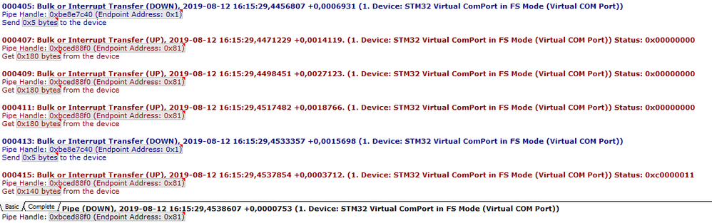

I'm sending a continuous data stream from uC to PC via VCP which is implemented as CDC. During stream every responded IN token for EP1 generates DIEPINT_XFRC, so I'm seeing interrupts:
DIEPINT_XFRC
DIEPINT_XFRC
DIEPINT_XFRC
Now I send something to uC and get these interrupts:
1. GINTSTS_RXFLVL (GRXSTS_PKTSTS_OUT_DATA_RECEIVED)
2.GINTSTS_RXFLVL (GRXSTS_PKTSTS_OUT_TRANSFER_COMPLETED)
3. GINTSTS_OEPINT (DOEPINT_TRANSFER_COMPLETED)
thereafter again, the stream to PC
DIEPINT_XFRC
DIEPINT_XFRC
But sometimes (I thing if the OUT token is received at some wrong uC USB stage) i get:
1. GINTSTS_RXFLVL (GRXSTS_PKTSTS_OUT_DATA_RECEIVED) //ok
2. GINTSTS_RXFLVL (GRXSTS_PKTSTS_OUT_TRANSFER_COMPLETED) //ok
3. GINTSTS_OEPINT (DOEPINT_TRANSFER_COMPLETED) //ok
4. GINTSTS_RXFLVL (SETUP_DATA_PACKET_RECEIVED)
5. GINTSTS_RXFLVL (SETUP_COMPLETED)
6. GINTSTS_OEPINT (USB_REQUEST_CLEAR_FEATURE) <---
Why clear feature? It seems that the core is not acknowledging the last OUT transfer and PC tries to reset the device.

‎2019-08-12 3:25 AM
bmRequest 2
bRequest 1
wValue 0
wIndex 129
wLength 0

‎2019-08-12 7:22 AM
So it's CLEAR_FEATURE on the *IN* endpoint 1 of the ENDPOINT_HALT feature.
IMO the host (PC) sees IN EP1 returning STALL on IN tokens, so it attempts to clear the HALT state of that endpoint.
‎2019-08-12 7:33 AM
It seems that there are 0x40 bytes missing in the last transfer so the host resets the endpoint.
‎2019-08-12 7:46 AM
Packet count is 1, that means one packet is still not emitted? It would explain 0x40 difference.
‎2019-08-12 8:12 AM
The mess starts if the OUT interrupt with 5 chars from PC is coming in during buffer load:
for (uint32_t i = 0; i < words_to_write; i++){
*(USB).DFIFO[1]=USB_buffer[i];
I've deactivated OTG_FS_IRQn interrupt before load and activated it directly after - now the bidirectional data transfer is stable.
