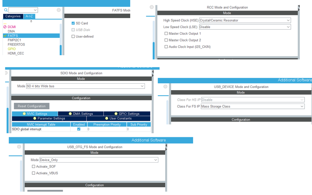

I am trying to configure with the SDIO and the USB mass storage. is it possible to have both option at the same time?
below is the configuration I did in CubeMx.
When compiling the generated source code, getting the below error. can you please guide something what could went wrong?

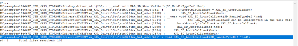

compiling syscall.c...
linking...
F466RE_USB_MASS_STORAGE\F466RE_USB_MASS_STORAGE.axf: Error: L6200E: Symbol HAL_SD_AbortCallback multiply defined (by stm32f4xx_hal_sd.o and bsp_driver_sd.o).
F466RE_USB_MASS_STORAGE\F466RE_USB_MASS_STORAGE.axf: Error: L6200E: Symbol HAL_SD_RxCpltCallback multiply defined (by stm32f4xx_hal_sd.o and bsp_driver_sd.o).
F466RE_USB_MASS_STORAGE\F466RE_USB_MASS_STORAGE.axf: Error: L6200E: Symbol HAL_SD_TxCpltCallback multiply defined (by stm32f4xx_hal_sd.o and bsp_driver_sd.o).
Not enough information to list image symbols.
Not enough information to list load addresses in the image map.
Finished: 2 information, 0 warning and 3 error messages.
"F466RE_USB_MASS_STORAGE\F466RE_USB_MASS_STORAGE.axf" - 3 Error(s), 1 Warning(s).
I searched the function it;s in two places.
how to fix it?

changing the IDE from Kiel to STMCube IDE worked :grinning_face:
