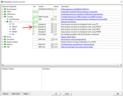

….after some googling I found that KEIL has ability to redirect STDOUT stream. This is apparently done by ticking checkbox (red arrow) in RTE settings:
Above picture says variant “Breakpoint” – “Stop program execution at a breakpoint when using STDOUT”.
One can change variant to “User”:
…then it says “Redirect STDOUT to a user defined output target (USART…..”
This sound like something I need.

Now we can see what each “variant” means.
Breakpoint variant should lead to:
#elif defined(RTE_Compiler_IO_STDOUT_BKPT)
static int stdout_putchar (int ch) {
  __asm("BKPT 0");
  return (ch);
User variant leads to:
#if   defined(RTE_Compiler_IO_STDOUT_User)
extern int stdout_putchar (int ch);
Now, if I choose “user” variant, compiling fails because linker can’t find function “stdout_putchar” in my code.
…..so If I choose “user” variant and rename fputc to stdout_putchar in main.c (effectively overloading function stdout_putchar from retarget_io.c) it should work? …well kinda. It has problem with buffers described here https://community.st.com/t5/stm32cubeide-mcus/printf-not-working-write-never-gets-called/td-p/276659
Adding “\r\n” on end of my original message “TEST_\r\n” fixed the problem.
…above mentioned thread also suggests using fflush() to circumvent \r\n issue.
Above suggestions seemed ugly, so I played with this a little bit more.
I chose variant “breakpoint” in RTE settings and changed back function name to “int fputc(int ch, FILE *f)”
…..and
printf("TEST_");
started behaving as expected. It transmits messages TEST_ as they come, each 1000 ms.
I can not explain why is this working.
I don’t know whether I have been clear enough, solution to my problem was ticking checkbox and leaving variant “breakpoint”, nothing else needs to be changed. Now I get “TEST_” in standalone mode (visible via UART to USB bridge).
