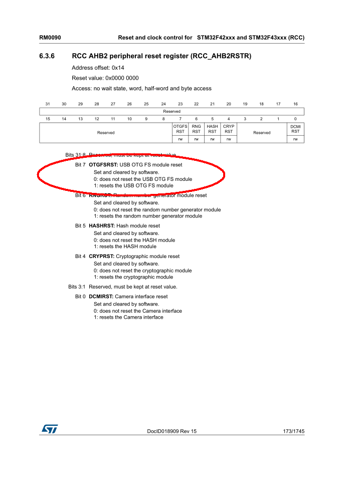

Posted on June 03, 2018 at 12:47
Reset the USB module using the RCC reset register.
Posted on June 10, 2018 at 09:07
Nope, did not help either.
I added
__HAL_RCC_USB_OTG_HS_CLK_DISABLE();
__HAL_RCC_USB_OTG_FS_CLK_DISABLE();
after shutting down the USB, then wait to give windows time to recognize the device change. Then it starts the boot loader and USB connection in windows fails with same error message.
That's how you meant it, didn't you?
Posted on June 10, 2018 at 09:14
No, I said reset in reset register (although disabling clocks may be a good idea too, there may be interlocks in RCC preventing changing clock source when they are used).
I don't know Cube incantation, I don't Cube.
