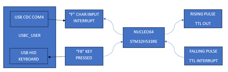

Dear STM32 Advisor,
I'll design a system based on Nucleo 64 H533RE. The system will act as USB CDC and USB HID Keyboard at the same time. The idea is when the CDC receive a character, here for example "F" then the Nucleo H533RE will output a high going pulse. And, if the Nucleo H533RE receive falling pulse external interrupt, the the Nucleo H533RE will press the F8 key. As a beginner on STM32, is it possible?

Hi @FuadPurnomo
Indeed the examples provided by @TDK  are interesting, you need to configure the USB device with two interfaces:
  • CDC ACM interface (for serial communication)
  • HID Keyboard interface (for keyboard reports)
You can refer to this article on how to Implement a USB HID keyboard device USB descriptors must reflect this composite device (2 interfaces). Regarding USBX, examples for CDC ACM exist (e.g., Ux_Device_CDC_ACM example for H533).
  1. Your CDC read thread usbx_cdc_acm_read_thread_entry already reads incoming data into a buffer.
for (int i = 0; i < actual_length; i++)
        if (UserRxBufferFS[i] == 'F')
            // Generate a high-going pulse on a GPIO pin
            HAL_GPIO_WritePin(GPIOx, GPIO_PIN_y, GPIO_PIN_SET);
            HAL_Delay(10); // 10 ms pulse, adjust as needed
            HAL_GPIO_WritePin(GPIOx, GPIO_PIN_y, GPIO_PIN_RESET);
Or triggering a hardware timer or PWM pulse if you want precise timing.
     2. Adjust function calls based on USBX HID keyboard API.
        // Prepare keyboard HID report for F8 key press
        keyboardHID keyboardhid = {0};
        keyboardhid.KEYCODE1 = 0x41; // Check HID usage ID for F8 from table  section 10 Keyboard/Keypad Page (0x07) in https://usb.org/sites/default/files/hut1_21.pdf
        // Send key press
        ux_device_class_hid_event_set(hid_keyboard, (UX_SLAVE_CLASS_HID_EVENT *)&keyboardhid);
        // Small delay to simulate key press duration to be adjusted to avoid debounce effect
        HAL_Delay(10);
        // Send key release (all zeros)
        memset(&keyboardhid, 0, sizeof(keyboardhid));
  • Use HAL_GetTick() or a hardware timer for accurate timing instead of blocking delays.
Best regards,
FBL

The hardware is capable of doing that.
I recommend buying a nucleo board, getting the existing relevant examples working, then extending it to your use case.
STM32CubeH5/Projects/NUCLEO-H503RB/Applications/USBX/Ux_Device_CDC_ACM at main · STMicroelectronics/STM32CubeH5
STM32CubeH5/Projects/NUCLEO-H563ZI/Applications/USBX/Ux_Device_HID_CDC_ACM at main · STMicroelectronics/STM32CubeH5
USB is not really a beginner project in any MCU.
So start with the basics first before moving on to advanced topics like USB.
