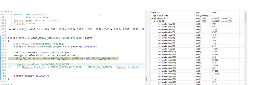

Hello, I am having some issues with STM USBD AUDIO library. For some reason I cannot get it to stream audio data to a host device in a proper way.
The device is successfully recognized as 2 channel 16 bit microphone by my PC.
When I press the record button in windows recorder or audacity nothing happens.
So far all I know is the USBD_AUDIO_DataIn is not getting called and from what I have read so far this is the function where I am supposed to be handling the sending data to host.
I have been trying to get this working for weeks and I have had it working in the past with the following conditions: I put the LL_Transmit function in the USBD_AUDIO_SOF function. This worked as the audio data is supposed to get polled every 1ms anyway. Then I had the problem that every other packet sent was empty, so I added the LL_Transmit function back into DataIn stage and now my sine wave was being sent perfectly. Which is really weird if you think about it. I cannot imagine that the library was designed to be used this way.
The weird thing is, if I do not use the SOF cb the DataIn stage is also not called.
I tried reading documentation but I just don't get this code. Too many layers too much stuff, and fully implemented for only speakers class so I constantly need to back up my workspace in case I do any "code generation" since I cannot work in the STM pre-approved user code spaces. Honestly I feel like throwing this whole library except the USB descriptors in the thrash. I mean previously I have also found the RM and registers much easyer to work with that STM Libraries and LL/HAL documentation. I'll just tell my boss to screw him and his time constraints. Since i'm not getting anywhere anyway.
Unless anyone here has some experience with this library and could tell me what I am doing wrong.
EDIT:::
Here is a picture of some code where I am trying to send just a single array over and over again.

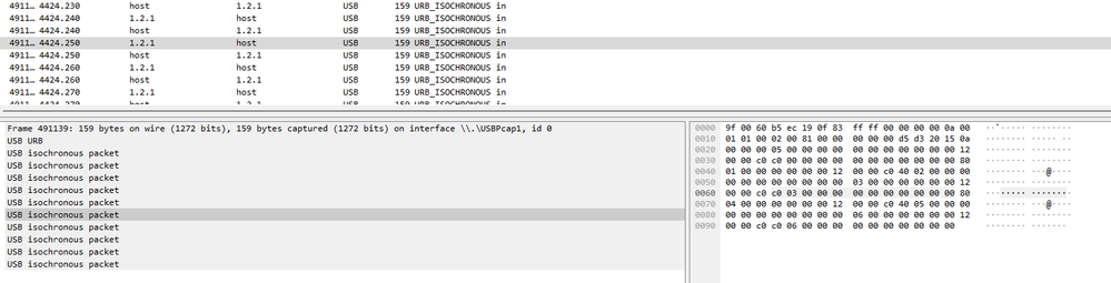

Here follows a picture of wireshank showing empty packets:
_legacyfs_online_stmicro_images_0693W00000bhfkxQAA.pngAs you can see
all packets are empty.
why?
Best answer by MWolt.1
If anyone is interested in the solution.
Ignore the Data in stage. Many examples of people who use it but I have encountered many more examples of people who can't get it to work.
Enable SOF
Just count the SOF in the USBD_AUDIO_SOF callback.
From main or whatever, send whatever amount of packets is required to be sent with the USB_LL_Trasmit function, whenever SOF > 0.
***** that we cannot use the interrupts but whatever it's an stm library.

I found the solution.
1) You do not need SOF interrupts, disable them.
2) STM32 HAL works perfectly fine. The problem emerges because the HOST reacts to USBD_LL_Transmit() only after several SOF frames. This means that USBD_LL_Transmit() in this code is useless:
USBD_LL_OpenEP(pdev, AUDIO_IN_EP, USBD_EP_TYPE_ISOC, USB_BUF_SIZE);
pdev->ep_in[AUDIO_IN_EP & 0xFU].is_used = 1U;
USBD_LL_FlushEP(pdev, AUDIO_IN_EP);
USBD_LL_Transmit(pdev, AUDIO_IN_EP, (uint8_t*)&someData, SEND_SAMPLES * 2);
3) All we need is to wait for some time (5 SOF frames on my Windows 11 system) after USBD_LL_OpenEP() and only then call USBD_LL_Transmit()
Bad way: call USBD_LL_Transmit() from SOF interrupt. As soon as you've got first USBD_AUDIO_DataIn() callback, only call USBD_LL_Transmit() from USBD_AUDIO_DataIn().
The good way: disable SOF interrupts. Monitor when HOST selected alternate mode, do a first USBD_LL_Transmit() with some delay from the main loop. All the consequent transfers will be automatically handled by USBD_AUDIO_DataIn(), from which you transfer microphone signal using USBD_LL_Transmit().
I will use the latter method in my mic for youtubers project. Both methods work and tested on STM32H7B0 under Windows 11, but I need to confirm yet if it is the same for Android/Linux and MacOS.
