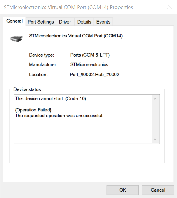

I Developed a hardware USB HS Application with STM32H750+USB3300, and just run the softerware generated by CubeMX. I make sure that the device is enumed successful by capturing the packets with wireshark. but it still show me an fail icon(an yellow exclamation mark) and report an error of error code=10, complete device status reported is
This device cannot start. (Code 10)
{Operation Failed}
The requested operation was unsuccessful.

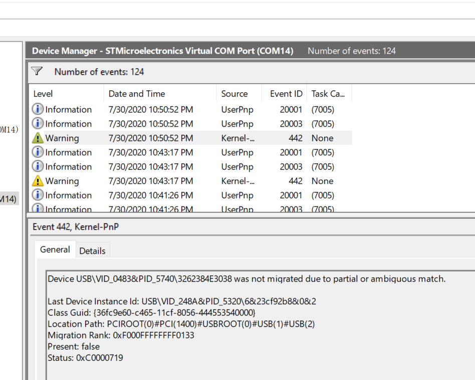

I noticed that the Windows 10 device event is:
Device USB\VID_0483&PID_5740\3262384E3038 was not migrated due to partial or ambiguous match.
Last Device Instance Id: USB\VID_248A&PID_5320\6&23cf92b8&0&2
Class Guid: {36fc9e60-c465-11cf-8056-444553540000}
Location Path: PCIROOT(0)#PCI(1400)#USBROOT(0)#USB(1)#USB(2)
Migration Rank: 0xF000FFFFFFFF0133
Present: false
Status: 0xC0000719
Ok, enumeration indeed was successful. Then the device acted unexpectedly.
Ignore this, not relevant .
