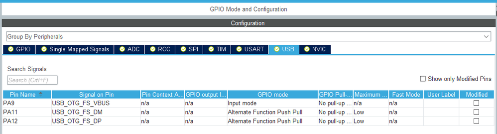

Hey, I'm using a STM32H743ZI. I'm trying to implement a callback function in my code but when I implement the IRQ_handler, the USB_CDC_FS stops working - when I remove the IRQ handler it works just fine.
The computer recognizes the USB port but I can't transmit/receive data.
Here's the pins defined for the USB:
And for the callback function I'm using EXTI_6 in the pin PB6.
I followed the example provided in the repository and here's the code:

SOLVED:
For the one's who might come up with this problem, check the startup_stm32h743xx.s file.
In .s the file the exti9_5 handler was being declared as  EXTI9_5_IRQHandler instead of EXTI9_5_IRQHandler_Config ans I did in the man file.
I changed the function name in the main.cpp to match the name in the .s file and it's working
