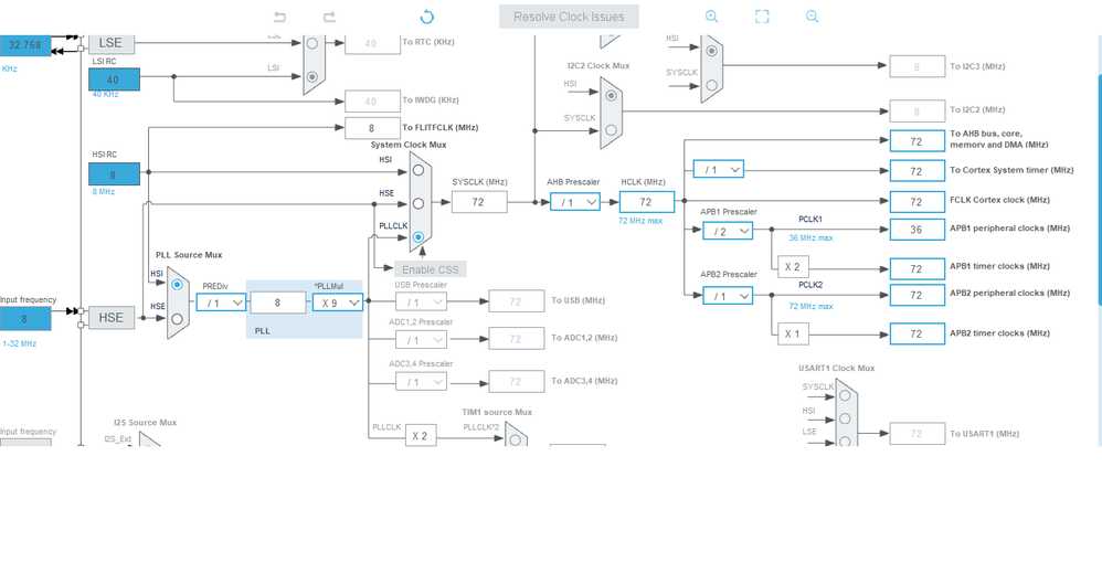

I'm trying to transmit a bitmap via USART. The bitmap transmits correctly in HAL. My project is register-based, written from scratch. The issue is that my USART has a speed synchronization problem—meaning:
  • When my C# terminal is set to 57600 BAUD, it reads one byte correctly, but an additional zero byte is received and written to the buffer index.
  • At equal speeds (115200 BAUD) for both the MCU and the terminal, it incorrectly reads the bitmap byte, and still receives an extra empty byte in the buffer.
I can't figure out what's wrong. I suspect it might be a misconfigured clock system. My board is Nucleo-F303RE (STM32F3xE). I’d appreciate your help!

	RCC -> APB1ENR |= RCC_APB1ENR_USART2EN;
	RCC -> CFGR |= RCC_CFGR_PPRE1_2;
	USART2->BRR = 36000000/115200;
	USART2-> CR1 |= USART_CR1_UE | USART_CR1_TE | USART_CR1_RE;
	USART2-> CR1 |=  USART_CR1_RXNEIE;
	NVIC_SetPriority(USART2_IRQn, 0);
	NVIC_EnableIRQ(USART2_IRQn);

FilipF303RE
@TDK Yes, You are right. Everythings work corretly when I change for 18 Mhz. I was just corious becasue IOC shows me in clock configuration that I have 36Mhz, but when I left not divided prescaler or divided by 2 I still have to set it for 18Mhz... It have pushed me to that I might had something wrong in my code ...
