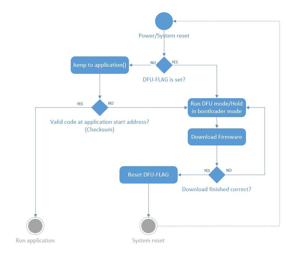

For my device i try to implement a simple bootloader which gives me the possibilty for DFU.
DFU works fine and everthing else too.
But I need some feedback if this is a attempt which ain�t gives me problems in the future.
My bootloader: 0x0800 0000 - 0x080 7FFF
Application: 0x800 8000 ...
Since i will have no reset button on my later hardware i want somehow jump back to the bootloader from my application and hold it in the bootloader until i upgraded the application.
For this i reserved a small part from the RAM: 0x2000 0000 - 0x2000 001F
For both the bootloader and the application i set the ram in the linker file to begin at 0x2000 0020.
Inside the small part of the RAM i write a specific value, if the application executes a specific function.(Basically i can send a request from outside to the mcu and it will execute the write function and do a reset).
By this the bootloader starts and reads out the specific value and holds the bootloader mode until the new firmware has been downloaded the value gets reset to default and a system reset is executed. So the bootloader starts again but jumps then to application.
This way I can avoid that the usb is configured all the time as DFU and I have a clean start for the bootloader and the application.
This works fine for now.
My Application is working with freertos and i think that the rtos could mybe access this part of the RAM somehow, but i am not sure. I hope excluding this part of the RAM in the Linker-Files will terminate any excess from the RTOS.
I am not that experienced in writing a bootloader and hope someone can give me a feedback if this is done well or if this can lead to a bunch of problems.

‎2018-06-05 4:48 AM
I'm using a similar method on another Cortex M based device (not ST, sorry ...).
But it seems you didn't consider the 'rainy day' scenario - the firmware update fails consistently, or is corrupted.
Our application has a customer-specific header including a checksum, and the bootloader calculates the checksum over the application each time, and remains in the BL if both values don't match.
You might consider a fall-back variant, which doesn't make things really easier.

Back to the bootloader stradegy: I fear most that with this stratedgy I could end up that the bootloader always tries to jump to application.
And I forgot to implement or I implemented a failing function which doenst that the variable in the RAM correctly. This would mean the bootloader wouldnt be hold the DFU mode.
‎2018-06-06 3:20 AM
So if this DFU-Flag is not corrupted by application (the value stored in RAM) and a valid code/checksum exists too. I will have the problem if my application do not have any function to set the DFU-Flag, I wont be able to run dfu mode again.
Even if I secure that this function to set the Flag is inside the application it could be broken or someone made a mistake in the program there is no possibility to run dfu mode again.

I thought of copy the old application into flash bank 2 as backup then eares bank 1 and load the new firmware into flash bank 1. If then something is corrupted the old application will moved back to flash bank 1.
That would certainly work, but usually the project management does not like the expensive idea of reserving half of the Flash.
The effort and safety you put into a bootloader should be justified by requirements of the device, and the update environment. The device I mentioned controls the movement of several metric tons of steel, so it must NEVER EVER get out of control, or people might die. A 'bricked' device is safer than a corrupt device.
Updates in my scenario are under direct human supervision, i.e. there needs to be a cable attached, and a (trained) person doing a sequence of manipulations. An update always happens with already existing application.
Only a proper implementation and appropriate tests will help here.Try the 'dumb' scenarios as well, i.e. the user pulls the power or USB plug during erase and during program.
Yes for sure. Things I haven´t concered, but should be part before every release of a firmware update.
My advantage or maybe disadvantage is that I am the projectmanagement.
For now the application doesnt even touches the half of the first flash bank and I don´t think it will sometimes. But I get your point.
This was the first idea how to fall back to a running system if the firmware update fails.
The device I mentioned controls the movement of several metric tons of steel, so it must NEVER EVER get out of control, or people might die.Luckily I have not that kind of critical enviroment.
A non-working device could 'only' cause a loss of production for our customers which could lead to huge loss of sales or penalties for not delivering in time.
So I always have to be sure the device runs again after a certain of time.
The DFU is only the 'small part' of the bootloader. The considered bootloader will have the possibilty to flash over ethernet, which will be my next task.
