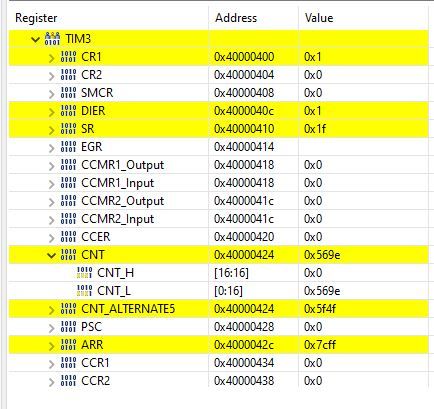

Timer3 disable/enable operation
We are using Timer3 to increment a uint64_t counter for serial port operation and need to be able to grab the counter value in the main loop.

Because the counter can not be retrieved in a atomic operation we initially disabled the interrupt and turned it back on.
	LL_TIM_DisableIT_UPDATE(TIM3);
	rc = timer3Tick;
	LL_TIM_EnableIT_UPDATE(TIM3);
The issue with this is that if the timer rolled over with the interrupt off, we would lose that tick count as the timer never stopped. We want to use the timer disable/enable to stop the timer, grab the counter and restart the timer exactly where we stopped it. Is there a document that can verify that when we restart the timer it does not reset the counter register Timer3->CNT?

waclawek.jan
Which STM32?
> if the timer rolled over with the interrupt off...
... nothing wrong happens. TIMx_SR.UIF gets set regardless, and after reenablin interrupts, it fires immediately.
You can easily test it - disable interrupts for a long time, toggle a pin and reenable - in the ISR also toggle a pin. You'll see both toggles on a scope/LA just after each other.
That is, if those functions or macros do nothing else but clear/set TIM_DIER.UIE.
OTOH, clearing  TIM_DIER.UIE won't *guarantee* atomicity of what comes after it. The story is long and I am tired, it's late here (the essence of it is same as of this). Just use _disable_irq()/_enable_irq() instead. Don't argue, just do it.

@waclawek.jan wrote:
The story is long and I am tired, it's late here. Just use _disable_irq()/_enable_irq() instead. Don't argue, just do it.
Thanks. Will do.
