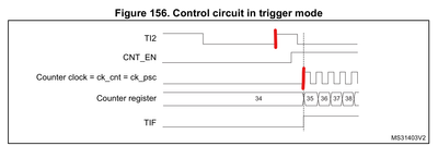

I have configured TIM15 as master.  In CubeMX I have set Master/Slave Mode (MSM bit) to "Enable (Trigger delayed for master/slaves simultaneous start)" and Trigger Event Selection to "Enable (CNT_EN)".
I have configured TIM3 as a slave.  In CubeMX I have set Slave Mode to "Trigger Mode" and Trigger Source to "ITR6" (per the reference manual).

I tried switching the run order of the MX generated timer initialisation functions, MX_TIM3_Init() and MX_TIM15_Init(), so that the master timer is initialised before the slave timer.  Now after both timers are initialised TIM3 CEN bit is NOT set and the TIM3 signal does NOT start until TIM15 is started.  I feel like I'm getting somewhere.  Of course it means I'll need to make this edit each time I regenerate the code so I'll review the timer selections eg use TIM1 instead of TIM15.
The next issue is the 10 kHz waveforms are not aligned.  There seems to be a few microseconds of delay between starting TIM15 (master) and TIM3 (slave) starting.  Is this to ne expected?  Is there a way to adjust this?
This is expected. It takes some time for the logic to propagate so master and slave will be a few ticks off. It should be the same amount of ticks each time. Two options:
  • Adjust CNT of the slave forward to compensate.
  • Set both of the timers to slaves in trigger mode and use a separate master timer that isn't related to an output signal to enable them.
The RM talks about this some.
Shouldn't be *micro*seconds though, given tens of megahertzs clock...
Even
  • setting up timebase and PWM in both TIM (no master-slave), except setting TIMx_CR1.CEN
  • disabling interrupts
  • setting TIMx_CR1.CEN in both timers
  • reenabling interrupts
should yield consistently sync within fraction of microseconds, at those clocks
