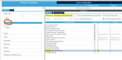

‎2024-03-13 3:27 PM
Thanks for the help! I had the same issue, but as you pointed out it was fixed by creating a new project starting from the CPU instead of the board.

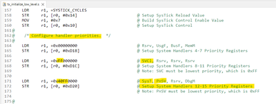

It seems it was the NVIC "Priority Group" setting that was wrong. It must be set to "4 bits for pre-emption priority, 0 bits for sub-priority". The default when starting from a board is "0 bits, 4 bits".
I think the root cause is that the Azure/ThreadX RTOS init code for the interrupt priorities in tx_initialize_low_level.s assumes "4, 0" bits, and does not handle any other case (?) But I haven't dug into this in detail. The HAL on the other hand seems to use the actual setting when writing to the priority registers.
The NVIC "Priority Group" setting is found in the STM32CubeIDE graphical pinout window (for the .ioc file), in the "System Core / NVIC" section. If it was set to "0, 4", then the "Time base" preemption priority should probably also be changed to 15 when setting it to "4, 0".
‎2024-04-11 2:03 PM
Hi JSmith,
The solution you provided worked. I was facing the same issue but after changing the preemption priority to 15 and the priority group to 4, it started resuming the task after the required delay.
Thanks
