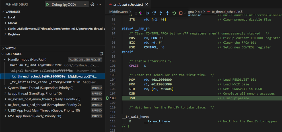

I am working on NUCLEO-U575ZI-Q. The code is generated with STM32CubeMX (using STM32CubeIDE) and the application uses ThreadX, which was added to the project using CubeMX.
When a thread call any function that would lead to a suspension of the thread, the function _get_ipsr() (file Middlewares\ST\threadx\ports\cortex_m33\gnu\inc\tx_port.h) is called and it directly triggers a Hard_Fault.
The error would trigger 100% of the time with some source code, and never with some other source code.
I am having this error for a while. I thought I found the solution before, but I was wrong and it was all just luck.
According to this link:
How to debug a HardFault on an ARM Cortex-M MCU | Interrupt (memfault.com)
There is a usage fault with the flag "UNALIGNED" raised. However please note that last time I had trouble with _get_ipsr(), the only flag set to 1 was in the "reserved" field of the usage fault register.
I still working on the issue but I am having trouble finding a solution. Do you have an idea on what could go wrong or how to solve this issue?
So I simplified the threads again and again to make them as close as possible as the examples, until I realized :
Although the execution of the function _get_ipsr() generates a crash, it is NOT responsible for the crash ; I was being very naive with the debugger.
The crash actually happens in an other thread, _get_ipsr() is just the last function called from a thread yielding, and leads to an other thread being run.
I found the source of the crash, could understand and solve the issue.
Thank you for the help.

@Bastien LS Did you find the solution? I may be having exactly the same problem on STM32U5A9, no trust - hard faults with UFSR=16 (unaligned), HFSR=0x400000000 (bit 30 set - forced). I cannot find any clear pattern to that. It is not a large code, plenty of SRAM, crash happens inside tx_* functions, e.g. tx_mutex_put(). When I step through it usually does not crash. I start to pull my hair out. MS has a newer version than than the one distributed by CubeMX. It seems it has some fixes.
I just found the problem. TX_APP_STACK_SIZE was simply too small.
