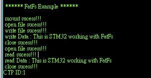

My mcu is H743, the MDMA is enable for SD. The FATFS is used to operate file system. CubeMX is used to generate template code.
Without the FreeRTOS, both of the FATFS functions f_write() and f_read () work correctly. But when the FreeRTOS is used, f_write works correctly(is checked by PC card reader) but f_read() get nothing (all of datas are 0x00).
the result without FreeRTOS is shown as following:
without FreeRTOS:
0693W00000DmdYAQAZ.jpgwith FreeRTOS:
0693W00000DmdY5QAJ.jpgthe test code for FATFS is show as follow:

Please give me advice or guide me to debug it. Thank you very much. Best Wishes!
Hello @KaoChin​
You can refer to the following application that exploits the features offered by FatFs with the microSD drive in RTOS configuration mode :
  • Projects\STM32H743I-EVAL\Applications\FatFs\FatFs_uSD_DMA_RTOS
This could help you.
