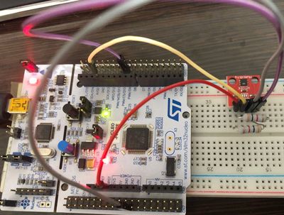

1 is HAL_ERROR which means the sensor is not connected properly. Recheck connections, including VCC/GND/SDA/SCL. Perhaps show a picture of the setup.
Get HAL_I2C_IsDeviceReady to return HAL_OK before you do anything else with the sensor.
I doubt the pullup resistor value is the problem here. Anything between about 120 Ohm and 10 kOhm will generally work.

Here's a picture and detailed explanation on the connections:
PB6 (purple wire) -> Sensor's SCL
PB7 (grey wire) -> Sensor's SDA
sensor's GND (yellow wire) -> MCU GND
sensor's 3.3V (red wire) -> MCU 3.3V
One leg of a 3K resister is put into the sensor's SCL pin and the other leg into sensor's 3.3V
One leg of another 3K resister is put into the sensor's SDA pin and other leg into sensor's 3.3V
1- Are the connections correct?

The device is not ready and the LED blinks fast, so there's a problem with making the device ready. Not?
And SDL was a typo, sorry, I meant SDA.

You don't check the HAL status when you call HAL_I2C_Master_Transmit or HAL_I2C_Master_Receive.
You're trying to calculate temperature with data that might not even be valid without first checking HAL status.
Check with an oscilloscope to be sure your signals are pulled up and you see data activity. Most scopes will have a I2C decoder so you can see if it ACK/NAK
