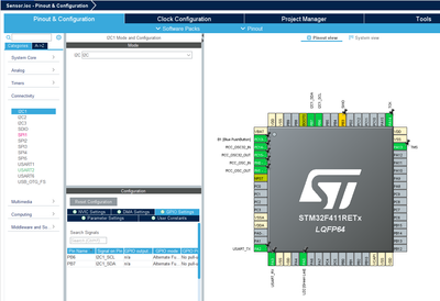

To get my first sensor project done and after selecting my board, I enabled I2C1 which triggered pins PB6 and PB7 as shown below:

The wiring is also this way:
PB6 -> Sensor's SCL (there's also a 220 Ohm resister between SCL and MCU 3.3V)
PB7 -> Sensor's SDL (there's also another 220 Ohm resister between SDL and MCU 3.3V)
sensor's GND -> MCU GND
sensor's VCC -> MCU 3.3V
The issue is that the LED is on while the room's temperature is obviously less than 40 degrees!
Any idea where the problem is, please?
