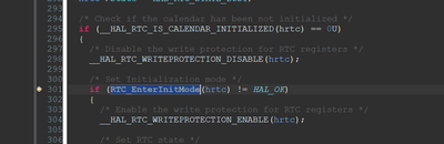

After connecting to a X-NUCLEO-LPM01A board for power consumption test , RTC init will not end.
Stuck in this while loop:
tickstart = HAL_GetTick();
/* Wait till RTC is in INIT state and if Time out is reached exit */
while ((hrtc->Instance->ISR & RTC_ISR_INITF) == 0U)
if ((HAL_GetTick() - tickstart) > RTC_TIMEOUT_VALUE)
return HAL_TIMEOUT;
Current solution: I have to program some example using stm32wbIDE, only that fixes it and I can now use my FW.

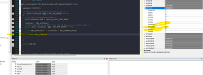

2024-01-23 08:09 AM
Please see attached system viewer, RTCAPBEN is EN

2024-01-23 01:11 PM - edited 2024-01-23 01:11 PM
Thanks, but I am actually doing that, ( the HAL is doing that for me to be precise)
i haven't changed the HAL functions, and using HAL_RTC_Init as is.
Any other flags that might be of help?
