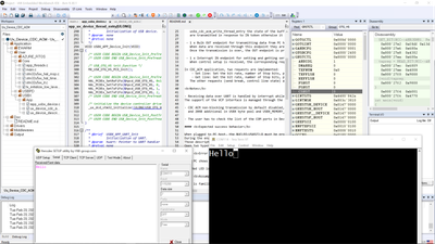

Here is a screenshot from debug view using latest version V1.4.0
Your issue is more likely linked to the version of CubeMX or the implementation. Would you share a failing and working project?

I have fixed the 1st issue where the peripheral is not activated for USB configuration. This code was not present in the (believed to be) V130 library (a working version from the demo example).
__HAL_RCC_SYSCFG_CLK_ENABLE(); (see HAL_PCD_MspInit())
It failed to start USB because it did not detect the power. I unable to debug why it does not invoke USB start because the source code is missing. See USBPD_CAD_Process()
I can see USBPD_CAD_Process() is used in V130 but not in V140 (from the assembly code). Both has missing source code USBPD_CAD_Process().
