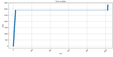

Maybe not relevant but here you can see that data is written after reinsertion.
