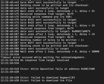

Hi, I integrated the OpenBootlader for the STM32L552 to my project and it works normally as expected. I'm only using the UART interface and reduced the boot loader project to the minimum.
The problem I'm facing is that sometimes the flashing stops, because the MCU is not acknowledging the messages from the programmer.
This is because the MCU is hanging in the USART receive loop:

I tried different UART speeds and the problem is not speed related.

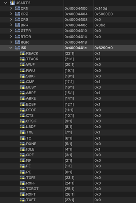

‎2024-05-21 3:59 AM
Have you checked for UART errors - Framing, etc ?
‎2024-05-21 4:58 AM
No errors when the issue occurs:
