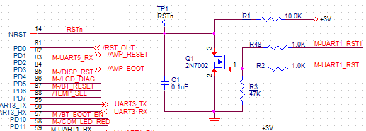

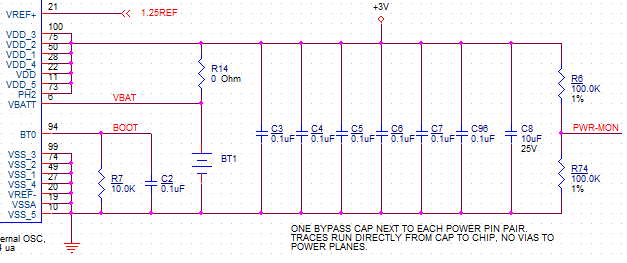

Are there significant capacitances to be charged? How exactly are the NRST, VDDA/VSSA, VBAT, VDDIO pins connected? Are all ground pins connected? Is the rise of VDD monotonic?
Posted on January 10, 2017 at 15:14
There are no significant capacitances to be charged, just some 0.1uF caps (at each IC).
NRST connection:
VDDA/VSSA, VBAT, VDDIO, GND pins (all grounds connected):
In our current test environment, VDD is actually a benchtop power supply capable of sourcing over an amp. It is monotonically increasing.

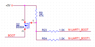

Here is the rest of the BOOT connection:
I have confirmed that the boot pin is 0V for the duration of the power-up, and that NRST is pulled high shortly after 3V is ready.

Thanks, will look into it. The battery is a rechargeable which is only used to power the RTC circuitry when +3V is no longer present.
Posted on January 10, 2017 at 17:07
Doesn't applying 1.25V to VREF+ and 3.3V to VDDA (22) violate specification?
Posted on January 10, 2017 at 17:23
Run through the DS/RM and it appears that specifically for the L4 family, no.
PH2 puzzled me a bit, but the pin number relates to VUSB, that should be IMO OK being connected to VDD too.
Sorry, I am out of ideas.
Posted on January 10, 2017 at 17:26
It seems that it does according to my RM0351 section 5.1 Power supplies:
VREF-, VREF+
VREF+ is the input reference voltage for ADCs and DACs. It is also the output of the
internal voltage reference buffer when enabled.
When VDDA < 2 V VREF+ must be equal to VDDA.
When VDDA ≥ 2 V VREF+ must be between 2 V and VDDA.
VREF+ can be grounded when ADC and DAC are not active.
And the DS DocID025976 Rev 4 Section 6.3.1.7 A2D converter characteristics mentions the same.
Posted on January 10, 2017 at 17:34
Indeed. The subscripted 'REF+'  escaped my textual search...  Sorry.
It is more tolerant than other STM32 models, which just want a diode drop (lest current backflow around the protection)
The DS I looked at covered the VDDA >=2V
http://www.st.com/content/ccc/resource/technical/document/datasheet/c5/ed/2f/60/aa/79/42/0b/DM00108832.pdf/files/DM00108832.pdf/jcr:content/translations/en.DM00108832.pdf
Not sure it is the issue here, but kind of the place I'd look for odd current flows.
Is the battery powering this?
gwillette
Posted on January 12, 2017 at 17:57
I removed the battery BT1 and lifted pin 21 so it is no longer connected to +1.25REF. The issue persists identically as before... And still no word back from anyone at ST help center.
