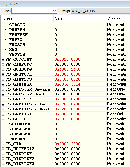

jvavra
Just getting back to this. Not sure how I missed it before, but for the project that is not enumerating properly, the BSVLD bit in FS_GOTGCTL is NOT getting set, indicating the "B-session is not valid". Not entirely sure what this means, as in neither case do I have VBUS sensing enabled (VBUSBSEN and VBUSASEN in FS_GCCFG are both 0).

I found a difference in how PA9 was set but it seems inconsequential; in the "working" project PA9 wasn't init'd at all (so I assume tri-stated). In the non-working project, it was init'd as an input with no pull-up, which I think effectively makes it also tri-stated. Either way, removing the init made no difference.

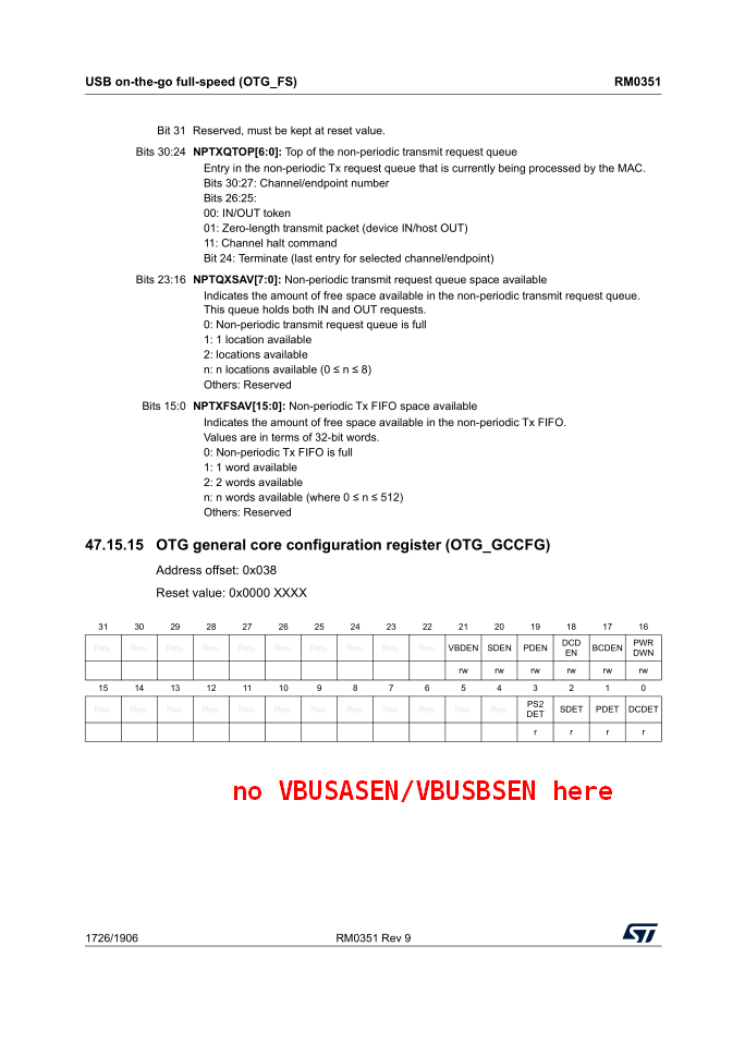

The contents of OTG_GCCFG are identical for both: the only bit that is set is the VBUS Enable Detection bit (VBDEN, bit 21).
This does not make sense.
If you don't use PA9 to detect VBUS, you should have VBDEN cleared.
OTOH, if OTG_GCCFG.PWRDWN=0, the USB can't be working in either case.
Waitaminute.
How comes you have VBUSBSEN and VBUSASEN in GCCFG, on an 'L496?
Ah, that's because I (foolishly) trusted IAR to be giving me the correct names for the bits in the register:
I apologize, I had a breakpoint inserted at the wrong position. After calling USBD_Start, the working project has ONLY PWRDWN set. The non-working project has PWRDWN AND VBUS Detection Enable set. So it looks like I need to figure out where VBDEN is getting set, and eliminate it.
