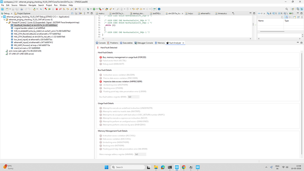

I am using STM32h757xih6 Controller Ethernet pinging data transfer issue came by using lwip and udp protocol getting hard fault handler (polling method)

@Nagavani wrote:
getting hard fault
See: debugging Cortex-M Hard Faults.
See also: LwIP debug & diagnostics.
PS:
Have you seen these Knowledge Base articles:
What do you want us to do about it? It's your code, debug the hard fault to understand why and address the issue.
Likely a memory overflow or stack corruption.

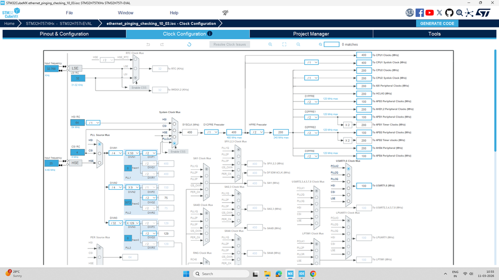

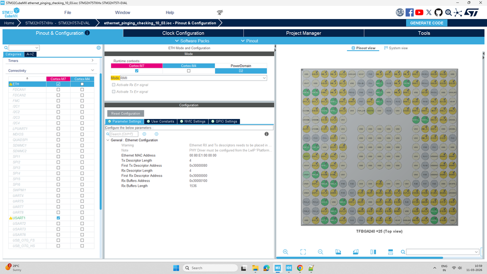

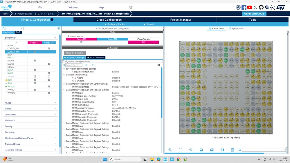

Nagavani
hardfault handlerhardfault handlereth clock configurationeth clock configurationeth addresseseth addressesmpu configurationmpu configuration

/* MPU Configuration */
void MPU_Config(void)
MPU_Region_InitTypeDef MPU_InitStruct = {0};
/* Disables the MPU */
HAL_MPU_Disable();
/** Initializes and configures the Region and the memory to be protected
MPU_InitStruct.Enable = MPU_REGION_ENABLE;
MPU_InitStruct.Number = MPU_REGION_NUMBER0;
MPU_InitStruct.BaseAddress = 0x24000000;
MPU_InitStruct.Size = MPU_REGION_SIZE_512KB;
MPU_InitStruct.SubRegionDisable = 0x00;
MPU_InitStruct.TypeExtField = MPU_TEX_LEVEL0;
MPU_InitStruct.AccessPermission = MPU_REGION_FULL_ACCESS;
MPU_InitStruct.DisableExec = MPU_INSTRUCTION_ACCESS_ENABLE;
MPU_InitStruct.IsShareable = MPU_ACCESS_NOT_SHAREABLE;
MPU_InitStruct.IsCacheable = MPU_ACCESS_CACHEABLE;
MPU_InitStruct.IsBufferable = MPU_ACCESS_NOT_BUFFERABLE;
HAL_MPU_ConfigRegion(&MPU_InitStruct);
/* Enables the MPU */
HAL_MPU_Enable(MPU_PRIVILEGED_DEFAULT);
