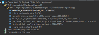

2) When I do download, install and run the Ux_Device_Audio2.0_PlayBack anyway, the program is running. I see the USB being enumerated as a speaker on my laptop. Issue is, everything is fine, but when I try to play an audio, it runs into a fault -- > `void HardFault_Handler(void))`
I can't tell where it's being called, but the stack is as such:
Any idea why I can't play audio out?

I quickly searched in the community forum what do I do for HardFault_Handler(). Saw someone mention Fault Analyzer, and it shows:
Hard Fault Details: Bus, memory management or usage fault (FORCED)
Bus Fault Details: Imprecise data access violation (IMPRECISERR)
I'm new to this technology and I did not add or modify anything in the example code. Not sure what to do next, but I'll keep searching on.

Thank you for your previous reply. I tried to apply your suggestions, but as I’m still new to this technology, I couldn’t fully follow them yet. For now, I reverted to the original configuration (with RTOS enabled) to focus on getting USB Audio working first.
I’m still stuck on a `HardFault_Handler()` that occurs right after playing audio.
Following the ST guide on debugging HardFault:
  • FORCED = 1
  • IMPRECISERR = 1 (imprecise data access violation)
  • MMFAR = 0x0 (no memory management fault)
The crash occurs inside `_ux_utility_memory_copy()`, line 88:
*destination++ = *source++;
The call stack shows it’s called from `USBD_AUDIO_PlaybackStreamFrameDone()` in ux_device_audio_play.c:155 (0x800131a)
When I step through the code just before the HardFault, the addresses are:
  • source: 0x240000A4
  • destination: 0x3071BFBA
It appears that 0x3071BFBA is not accessible, causing the fault.
I’m not sure why this address is being used... I am using STM32H753I-EVAL2.
At this point, I'm not sure what to do next. I appreciate any guidance.

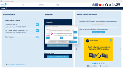

Just to recap, this is what I did.
  1. Opened STM32CubeMX
  2. To create a new project, I press "Access to Example Selector" (side note, I get a popup with "Problem during download..." see image below, which I'll press okay and then it'll say "Download has failed, some data may not be updated". )
  3. New Project from Example pops up. I search for Audio and I see "Ux_Device_Audio2.0_PlayBack". I double click that.
  4. Start Project from Example pops up. I change "Install Project Directory" to "C:\Users\audio\STM32CubeIDE\workspace_1.19.0" and open with "STM32CubeIDE
  5. I plug in the ST link USB, I build and run the debug. I plug in USB to OTG_HS and laptop. USB enumerates as "STM32 AUDIO20 STREAMING", but crashes as soon as I press play audio, which is explained in the first post above.
