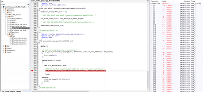

2) When I do download, install and run the Ux_Device_Audio2.0_PlayBack anyway, the program is running. I see the USB being enumerated as a speaker on my laptop. Issue is, everything is fine, but when I try to play an audio, it runs into a fault -- > `void HardFault_Handler(void))`
I can't tell where it's being called, but the stack is as such:
Any idea why I can't play audio out?

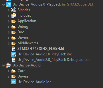

Changing MCU
I followed the  UM1718, tutorial 5 to try to change the MCU, and imported it. Unfortunately it won't run as it removed a lot.

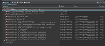

Thank you for sharing the project file, however, after cleaning, building caused some issues:
At this point, however, I should be able to compare the two projects and see what changes you made to make it a standalone, that should allow me to build it successfully in the newer project.

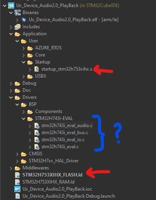

RE: Changing MCU
I kept the existing project of the Ux_Device_Audio2.0_PlayBack (reverted all changes), and changed the two files I mentioned above - see here:
I am not sure what the best practice is, but that's what I did. If there's a safer/better way to do so, please let me know. As for the blue question mark, I assume it's safe to keep it there even though I work with H753 (screenshot shows H743). If this is acceptable, consider this change "solved".

I have cleaned and rebuilt and it is still the same result. I even went back to the original example, and the program goes into hardfault if I don't change the == into >= in line 5 below of ux_device_audio_play.c:
 if (length)
    BufferCtl.wr_ptr += frame_length;
    if (BufferCtl.wr_ptr >= AUDIO_TOTAL_BUF_SIZE) //THIS LINE IS CHANGED
      /* All buffers are full: roll back */
      BufferCtl.wr_ptr = 0U;
      if (BufferCtl.state == PLAY_BUFFER_OFFSET_UNKNOWN)
        /* Start BSP play */
        BufferCtl.state = PLAY_BUFFER_OFFSET_NONE;
        /* Put a message queue  */
        if(tx_queue_send(&ux_app_MsgQueue, &BufferCtl.state, TX_NO_WAIT) != TX_SUCCESS)
          Error_Handler();
with this change, and even with the startup file and linker filed changed to H753, I still get the audio looping, and with the BSP_AUDIO_OUT_Pause(0), I get NO audio.
