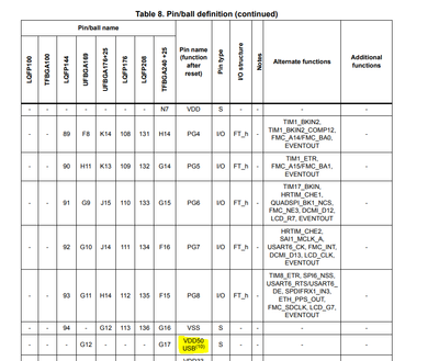

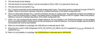

On the NUCLEO-H753ZI board, which features a microcontroller in an LQFP144 package, it is expected for the USB33RDY flag to remain unset. it is mentioned in the MCU datasheet that when the VDD50USB is not available on the package, the pin will be tied internally to the VDD33USB. See the screenshot below from the datasheet DS12117 Rev 9

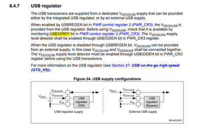

In this case, it is necessary to use an external USB supply as mentioned in the reference manual RM0433. Please see the screenshot below:

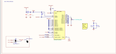

For the NUCLEO-H753ZI board, the VDD33USB pin is connected to 3.3V via solder bridge SB13. Please see the schematic below.
If your setup does not use the TFBGA240 +25 or UFBGA169 package, in your application, you should disable the USBREGEN bit then enable the USB33DEN bit. There is no need to check the USB33RDY bit, as it is not expected to be set.
