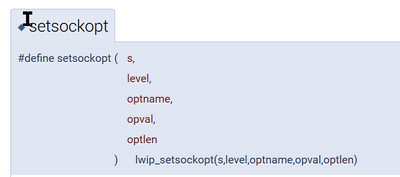

The Wiki content for the socket API is just a regurgitation of the header file for the macro or function. Here is the entry for setsocketopt:
Now I'm guessing that setsockopt sets some options for the socket the application programmer is trying to instantiate. But it doesn't explain that, or what the various macro parameters do and what valid inputs they can be.
I am guessing that s is the socket handle, but what the rest of them are is beyond me. An application Programming Interface needs a lot more than code it needs an explanation of what the function does, when you should use it and what its parameters are.
