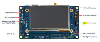

‎2024-07-16 3:07 AM
Hello @NRedd.2 ,
To ensure proper functionality, you must plug the MB1299_Microphone_MEMS_Module into the STM32H735G-DK ( on CN20). We have tested the example using this MEMS module, and it works correctly.
STM32H735DK board :
STM32H735dk
Microphone MEMS Module :

‎2024-07-16 4:56 AM
Hello @MOBEJ ,
Thank you for the quick response!
I assumed that the example provided (DFSDM_AudioRecord) was for U33 MEMS mic which is onboard on the top side.
Is it not the case?
If so, do you have an example for the onboard MEMS?
Best regards,
Navin
