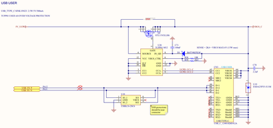

I have also not done anything with the UCPD, though the nucleo is wired to a Type C port with another IC involved for USB C PD control. Could this cause the PHY to not startup?

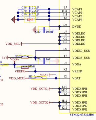

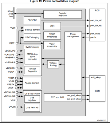

There are two regulators on the chip :
 - USBREG
 - USBHSREG
USBREG is discussed in some detail in the reference manual, and the schematics of the nucleo show that it is connected to an external 3.3V supply. This supply is related to the VDD33USB pin. Enabling USBREG makes HAL_PWREx_EnableUSBVoltageDetector() error out.
USBHSREG does not seem to be discussed in the reference manual, and the phrase "USBHSREG" shows up only in the register map. It does need to be enabled. If it is not enabled, HAL_PWREx_EnableUSBVoltageDetector() reports no errors, but the PHY remains unpowered.
From the power control block diagram, I assumed the HS PHY draws power from DVDD, which is powered by VCAP in the schematic. The internal LDO is enabled by `HAL_PWREx_ConfigSupply(PWR_LDO_SUPPLY)`, so VCAP should be powered and I presumed that would be enough. My reading of the documentation was that USBREG and USBHSREG are similar, one for the FS and the other for the HS.
On a side note, I have not had to do any configuration of RCC_MCOConfig. As far as I can tell, MCO is disabled. USB HS works fine. The STM32H7S3L8 has an internal HS PHY - perhaps the MCO config is needed when using an external PHY?

 For basic data transfer and fixed power supply, UCPD controller is not necessary but you need to check your hardware setup like the following example implementing TCPP port for sinking power connected to CC lines and enables VBUS power path.
