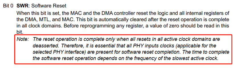

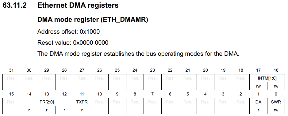

I got a new STM32 Nucleo-H723ZG, now i am testing about many days, but i have a big Problem, is use the new Stm32CubeIDE 1.5.2 with actually Firmware for the MCU.
The Problem is, i loaded a new Cube Project with Default Values, for the Board without any Changes, now when i run or debug my project, hangs my MCU on this Code:
HAL_ETH_Init:
/* Ethernet Software reset */
/* Set the SWR bit: resets all MAC subsystem internal registers and logic */
/* After reset all the registers holds their respective reset values */
SET_BIT(heth->Instance->DMAMR, ETH_DMAMR_SWR);
/* Get tick */
tickstart = HAL_GetTick();
/* Wait for software reset */
while (READ_BIT(heth->Instance->DMAMR, ETH_DMAMR_SWR) > 0U)
if(((HAL_GetTick() - tickstart ) > ETH_SWRESET_TIMEOUT))
/* Set Error Code */
heth->ErrorCode = HAL_ETH_ERROR_TIMEOUT;
/* Set State as Error */
heth->gState = HAL_ETH_STATE_ERROR;
/* Return Error */
return HAL_ERROR;
i got an HAL_ERROR, and the MCU Goes to from the Main Function to the Error_Handler...
What is the Problem? This code is generated from the MxCube and its unchanged...

‎2023-01-05 10:13 PM
check phy clk or rst
