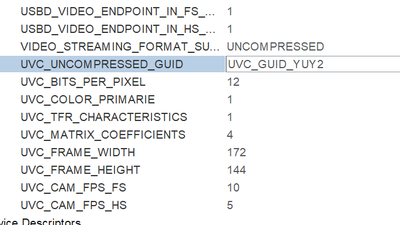

I'm running an "Ux_Device video" example on NUCLEO H723ZG", but it doesn't work in Uncompressed mode.
My setup is:
With stream2.h  like source.
Can someone help me with the configuration?... Where can I get information about this?

Hi @Monk Eastman , Welcome to our community To stream UNCOMPRESSED video you need to configure your device with Width = 176, Height = 144, Regenerate Code with cubeMx to update device descriptor and include stream2.h insteated of stream1.h.

Uncompressed - maybe data rate is too high ? check your settings.
