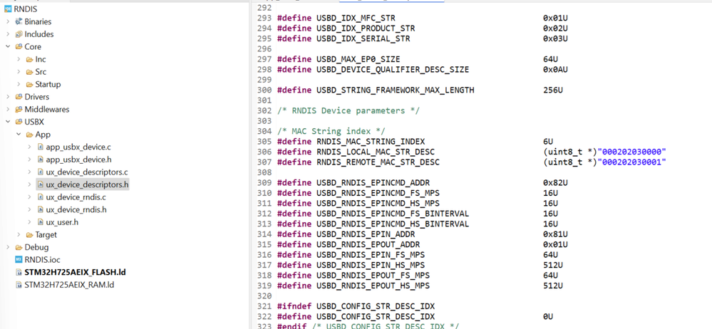

I have a problem with USBX RNDIS.
The generated code on file ux_device_descriptor.h  at line 308 is:
#define USBD_RNDIS_EPINCMD_ADDR 0x81U
In the exemple code of STM32H735-DK find on stm32-usbx-exemple repo I have this
#define USBD_RNDIS_EPINCMD_ADDR 0x82U
The USB device is well recognized be my computer (windows 11) only if the value is 0x82U.

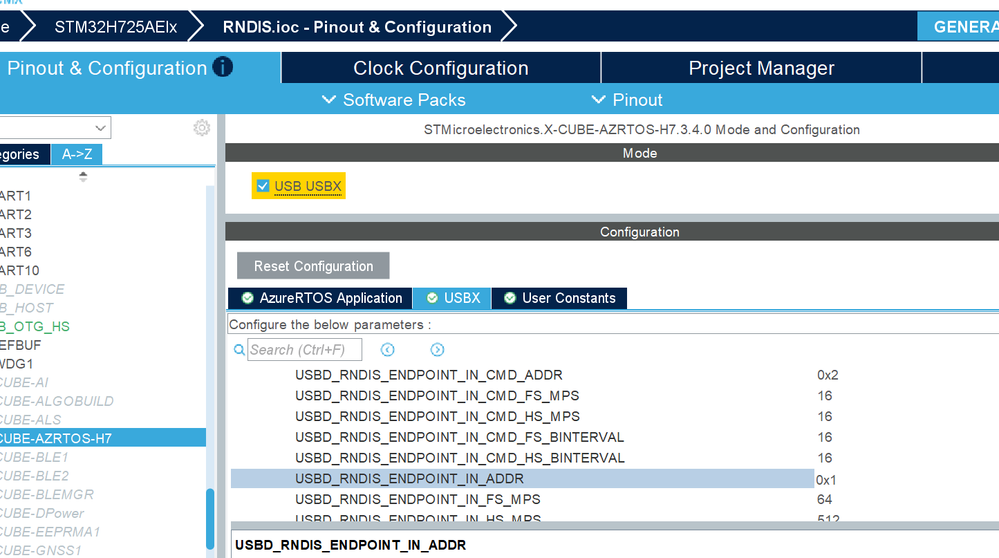

Hi @Dams
With the configuration below, the code is generated correctly. In particular, the IN endpoint address and the IN endpoint command address are assigned the additional values 0x81 and 0x82, respectively, since bit 7 indicates the direction (0 for OUT, 1 for IN).
I hope it's clear.

This behavior is related to the role of this endpoint. The USBD_RNDIS_EPINCMD_ADDR is the command IN endpoint, and its direction and index.
If USBD_RNDIS_EPINCMD_ADDR is set to 0x81U, it conflicts with the data IN endpoint configuration, and the device is not correctly handled by the host. That’s why it only works correctly when USBD_RNDIS_EPINCMD_ADDR is set to 0x82U, as in the reference example.
/* EP_IN, EP_OUT, CMD_EP */
#define USBD_RNDIS_EPIN_ADDR                          0x81U
#define USBD_RNDIS_EPOUT_ADDR                         0x01U

Hi @FBL
Thanks for feedback. According to your answer, I think the generated code from Cube is not correct. In the file "ux_device_descriptor.h" the value of USBD_RNDIS_EPINCMD_ADDR shall be set to 0x82U intead of 0x81U.

Hi @Dams
I hope it's clear.
Best regards,
FBL
Dams
Hi @FBL ,
Thanks for the solution:
Have a nice day.
