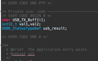

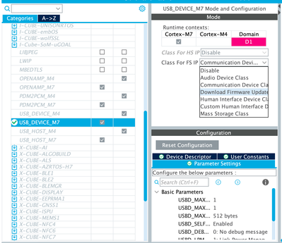

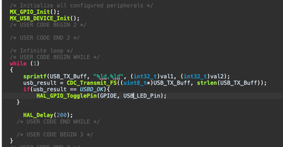

I am trying to use STM32H747IGT6 as a USB device. I want to sent data using CDC. Below you can find my configuration and code. The MX_USB_DEVICE_Init() is successful. Although when I call the CDC_Transmit_FS, it never returns USB_OK and I wasn't able to find the USB device through my laptop.
The only thing I found is that after the initialization done by the ST Generated code, the struct with the device configuration is still NULL and it seems that nothing is actually initialised and I assume that this is a problem. Although the initialization function returns USB_OK.
Does anyone have any ideas about this problem?
If you need further information about the project please let me know.

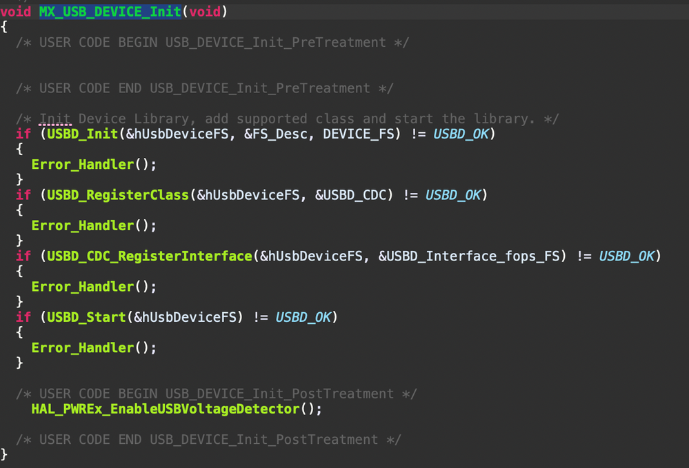

can you please send the generated MX_USB_DEVICE_Init() function and give more details about the CubeMX version you are using to further investigate your issue ?

I am using the version 1.14.0 of STM32CubeIDE
Here is the MX_USB_DEVICE_init()
I tried moving HAL_PWREx_EnableUSBVoltageDetector() above the other functions(inside USER CODE BEGIN USB_DEVICE_INIT_PreTreatment) but nothing changes.
Thank you in advance

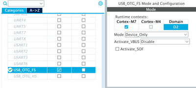

Your code uses "HAL_PWREx_EnableUSBVoltageDetector()" but VBUS sensing is disabled in your cubemx configuration? At least, I suppose that's what "HAL_PWREx_EnableUSBVoltageDetector" is for but I'm not sure. It's worth to verify that too.. The easiest (if you don't need it) is to keep vbus sensing disabled.
